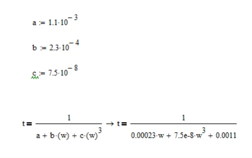

In general you should attach the worksheet, not just a picture.
Other than that: Mathcad did exactly what you asked it to do. You asked a symbolic evaluation of the expression, and you got it: t expressed in terms of w. A bit nicer could be:

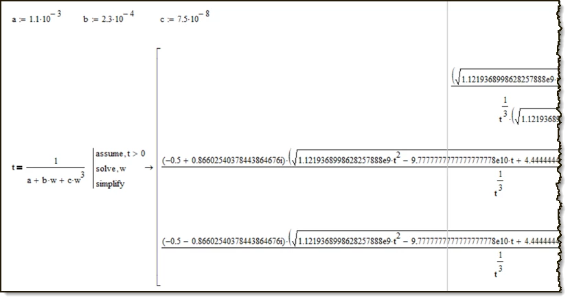

If I ask it solve for w, I get 3 possible answers (I'll show only part of them):
Note that each of the three answers involves t, the (other) unknown.

But I dont know why the behavior is not identical with other equation attached screenshot (sorry). I tried multiple times to upload the file but could not do so attached the file.

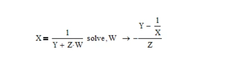

What do you mean by "behavior not identical"?
In your first pic you showed the symbolic evaluation of an equation without using "solve" and so the equation was simply repeated (and a bit simplified).
In your last pic you show an equation symbolically evaluated with "solve,W" and consequently you get the equation solved for W.

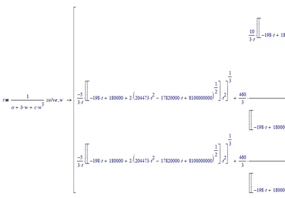

And, yes, those solutions are quite ugly:

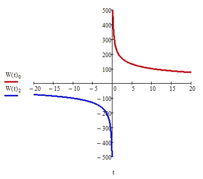

You may assign the result to a function and evaluate it for different values of t:
You may also use this function for plotting:
