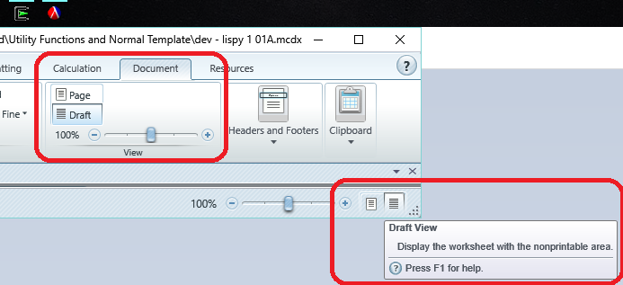

One solution would be to define all your variables in the non-printed region to the right (use "draft view" instead of "page view").

Thank You. That works very well. I am not sure what the other person said about page view I couldn't find anything like that.

Nov 9, 2015 3:49 PM UTC
Prime has two document display modes: Page and Draft.  Page shows what Prime will print, whilst Draft allows you to access more non-printing pages to the right of the printable pages.   You can toggle between the two modes by either using the Page and Draft button in the Document tab on the Ribbon or by using the Page and Draft buttons at the right of the status bar.
