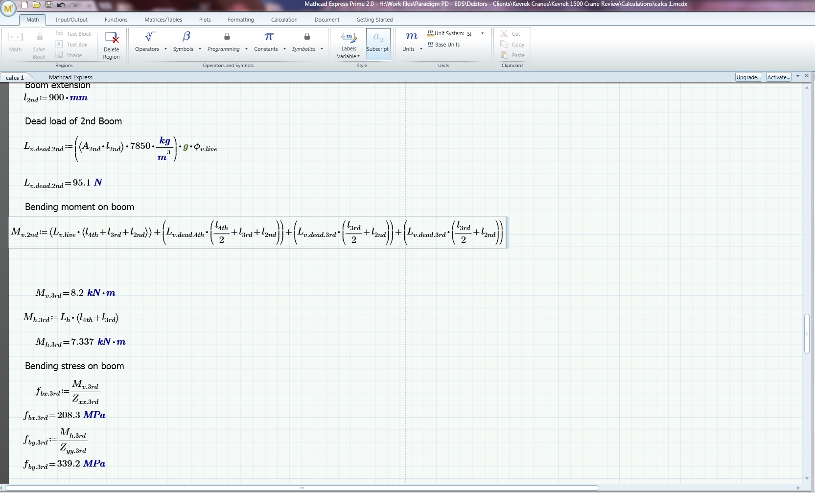

Can someone please tell me how I can stop my equations from spreading over two pages?
I know there used to be an easy way to do this but I have forgotten howscreen.jpg

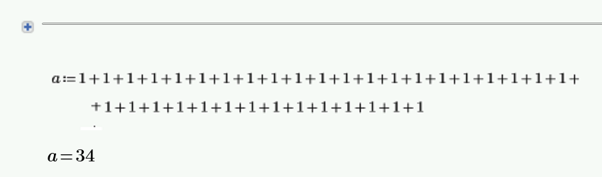

Jun 17, 2015 1:52 PM UTC
In Mathcad 15 you can split the expression to a new line at a summation operator, but (like many things) this is not available in Mathcad Prime.

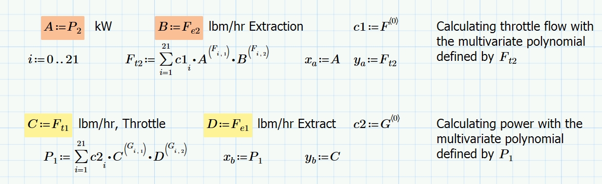

Hi John,
I had the same problem recently when trying to use a polynomial with 21 terms. It was really long. Anyway, I was able to use the summation operator to define the equation and that worked really well. To make it work, The various terms of the polynomials were written into arrays and the summation operator referenced the array columns. Looks like this:
I can send you the Mathcad file if you'd like to see it, just let me know.
