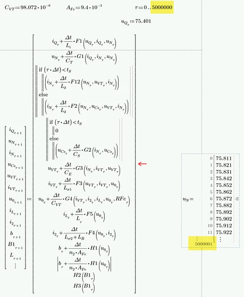

I could only test with Prime 6 and I experience no problems with a larger range tau.
I could setup tau with over 5 millions steps without any error.
So either there is a problem with your installation of Prime or once again Prime was "developed" in the wrong direction. Maybe someone with P7 or P8 can testdrive your sheet and report the results.

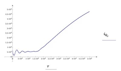

Here a screenshot of P6:
