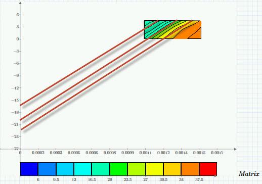

Hi all.  Here's my question.  I would like to be able to line fit an iso-line.  Mathcad clearly can generate the data for the iso-line since it plots it on a contour plot.  Is there a way to get the coordinates of the iso-line so that I can fit it to calculate the y-intercept? Or maybe there's a completely different way to solve this problem.  Attached is the Prime 3.1 file and pdf that will explain what I'm after more clearly.
Basically I'm trying to generate the red lines I've overlaid here (with a paint program)

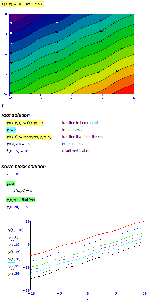

Unfortunately, Mathcad doesn't actually generate the isolines.  This is a function of the plotting 'component' and the values are private (there is a long, long, long standing feature request to make this information available from the plot).
However, Mathcad has a few ways of generating the isolines, the complexity of which will depend upon the nature of your function.   As it looks fairly simple from the image, I'lll give an example of two methods (in Mathcad 15, but should port to Prime) using the root function and a solve block.
Stuart

I have just realized that what you are trying to do cannot work. You say "Larson-Miller considers that iso-stress lines intersect the y-axis at a constant point". However, to be able to extrapolate the isolines as straight lines to 1/T=0 (so T is infinite - seems strange to me) would require that the isolines are straight lines (or the points generated from them are in a straight line), which in turn means the surface is a plane. However, if the surface is a plane then the isolines are parallel, and will not meet at the y-axis (or anywhere else!). For isolines (i.e. contours) to intersect the gradient of the surface has to become infinite.
June 23, 2016
Try this. I'll leave you to fit lines through the data sets. I don't need to do that to tell you that they will not intersect at the y-axis.

I guess I couldn't resist
I suppose you could just take the average of the intersection values. Better than nothing perhaps.
