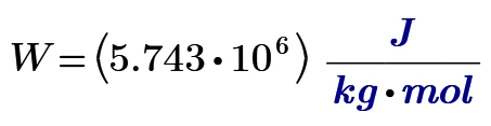

I ran into a problem where Mathcad 8 (or 4 which I used previously) does not show the correct value or units for a calculation. I would send you the file with the calculations but I see no way to do so with this form. This may be the only error that I have detected while running Mathcad over the years.

I am attaching file which shows my problem.

Change the label ow R in W to variable. Then you get the W you want.
