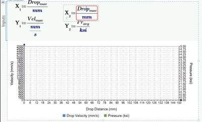

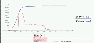

I have a series of calculations that I've been doing in Prime 10 with no problem.  Now that it is opened in Prime 11, I get a plot error "These array elements must be scalar".  The plot still generates.
It will not pass to a chart element and work.
See attached document and data file.  Any ideas would be appreciated.

Unfortunately you posted the sheet in P11 format so we cannot test if it would work in P10.
But I sincerely doubt that it would work in P10 as the problem is that the vector Pr.avg which you use for Y2 is nowhere defined.

This is combination of feeling silly and baffled.  The second problem of the loss of definition Pr.avg  was just plain silly.  The pervious one with has gone away since I closed and reopened the document.
