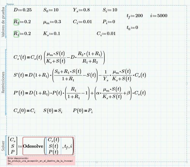

I'm doing a EDO resolution, and at the end of the resolution block I get error "Exception has been thrown by the target of an invocation"". If someone understood how to solve or the reason for this error. Thanks

You should attach the worksheet, not only a picture, and state which version of Prime you are using.
All i can see in your picture is that:
- alpha and beta are undefined.
- There appears to be a multiplication symbol (*) missing:
    - in the first differential equation, between C(s) and (mu.m...)
    - in the other two DE's between D and (1+R.1), which makes D seem like a function.

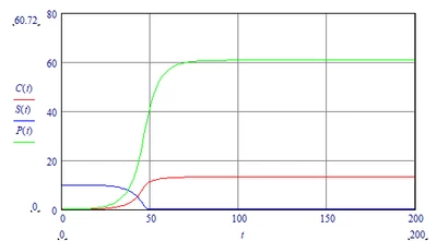

For alpha=beta=1, I get:

Jan 30, 2025 7:06 PM UTC
Thanks a lot, the error was due to 3 missing multiplication symbol. Thank you very much
