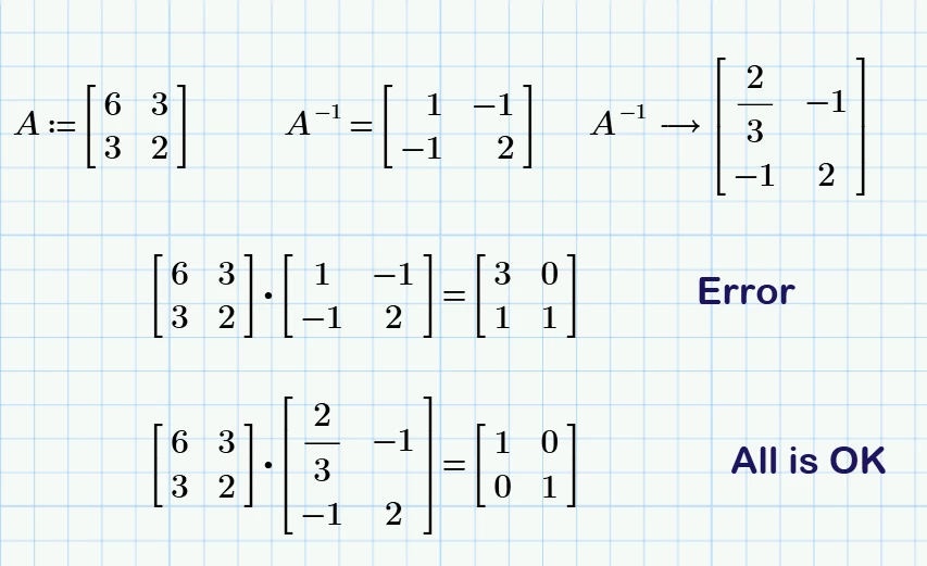

When evaluating the inverse Matrix of A, i got two different results in MP4 using the symbolical evaluation and the evaluation with "=".

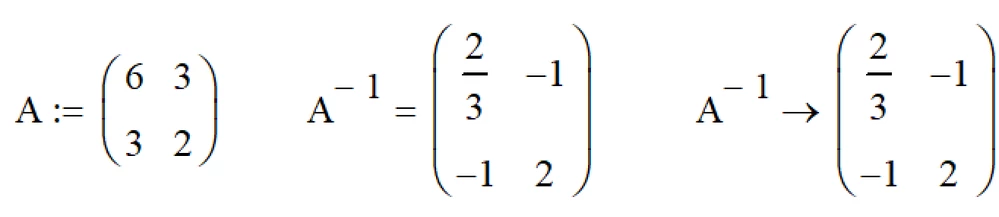

Creating the same inverse Matrix in MC15 does give the same correct results by evaluating the same way like above.

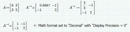

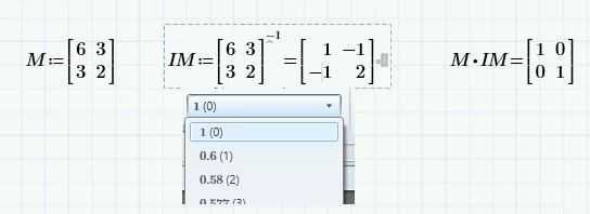

I can't open your file and just gave it a try with Prime 3.0.
Here all ist OK as it should be.
Only if I set the math format to "Decimal" with 0 decimals displayed, I get the result seen in Valery's pictures.
So unless you accidentally used that misleading setting in your sheet, its definitely a severe bug introduced after P30.
What do you get if you evaluate A*A^-1= ? If you still get the identity, its just a display probem, otherwise its an even more fatal bug.

I think it is a bug in Mathcad Prime 4!
All OK in Mathcad 15
