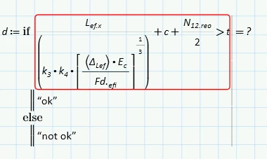

error in if function
The  error is - "The value must be a scalar"
terryhendicott

23-Emerald V
Apr 17, 2025 5:32 PM UTC
The other point is: Did you type the square brackets? If you did, remove them.
By typing a square bracket, you create an Array, or Vector, and that is not a scalar.
You should NEVER type a square bracket to create a subset of an expression, Prime will change the look of ordinary (round) brackets to square if it sees fit to do so, but they will still be treated as round brackets, and that how you normally want them.
So if you typed the square brackets, remove them and replace them with round brackets if needed, but I guess Prime will put in round brackets automatically once you remove the squares.

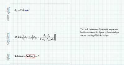

7-Bedrock
Apr 18, 2025 3:48 AM UTC
Awesome, thank you.
I trying to use solve block and getting some errors ,
I use prime 10.0, I have uploaded my sheet, open to suggestions to do it another way
