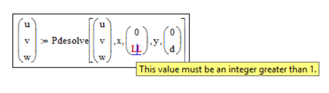

I'm trying to solve a "standard" 2D partial differential equation but the Pdesolve function gives the error: "The initial conditions are not consistent with the endpoints specified in the temporal range". I don't understand why.
I also copied the Worksheet example on using Pdesolve into the file and it gives "Unknown error".
I'm attaching the file in MC14.

The error message in Mathcad 15:
I tried to solve problems by using functions pdesolve, but soon understand that this function is flawed and it did not take into Mathcad Prime. Or I do not understand this function.
