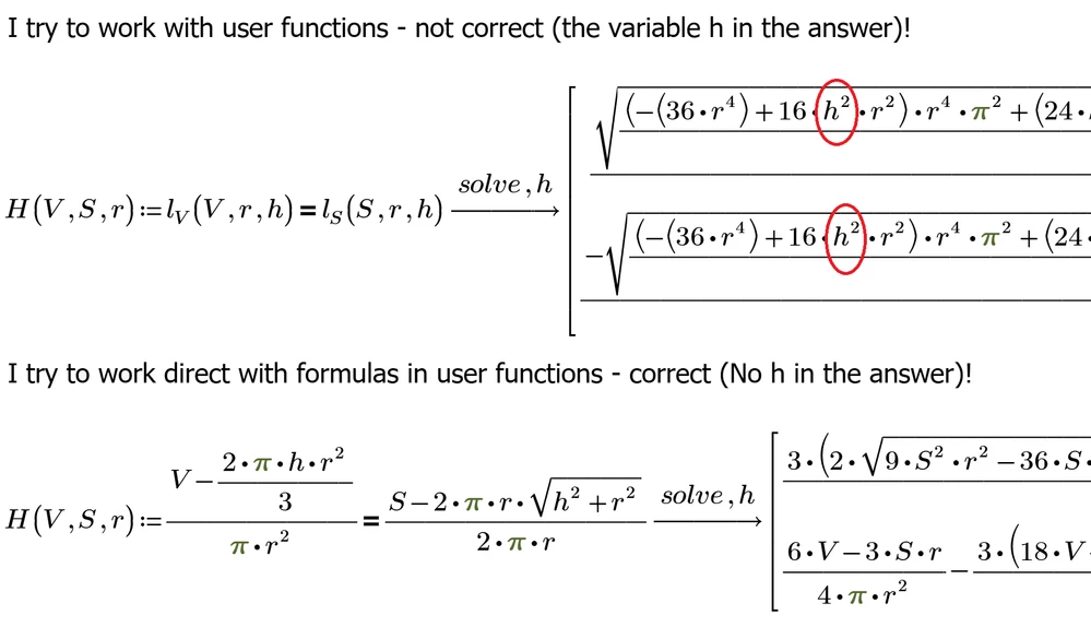

Yet another fine feature of Prime: autolabelling, where Prime will automatically set the label of an identifier depending on its use, its position or whatever. And every that is automatic, can go automatically wrong and create beautiful riddles, such as this one.

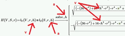

Your h's aren't the same; the ones with a v arrow are labelled as variables, those with an a are automatic. That makes them different. Prime solves for the automatic h, so it keeps the variable h in the solution.
It would certainly help to make the display of each of the labels show distinctly different, that way you will immediately see that your h's are different.

Check the Labeling of tau and h. From Variable and Auto to Variable and Variable.
