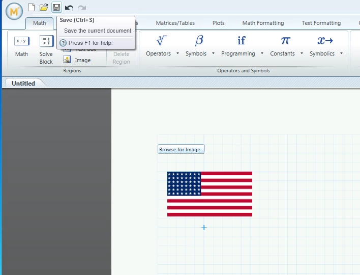

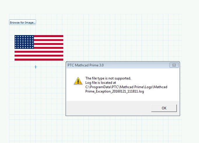

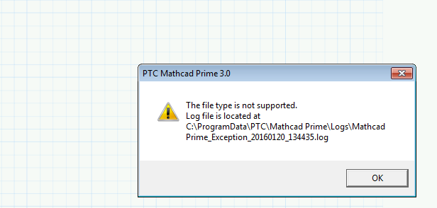

I am using MCP 3.0 and I cannot insert an image.  If I use IMAGE block and browse to my picture nothing happens.  If I open the picture in another program and copy and paste into MCP it works but then the document will not save.  I get an error "File type not supported" and a log file is generated.  I have tried jpg. bmp, png, tiff and nothing works. I also tried it on another computer, 1 with MCP 3.0  and 1 with MCP2.0 and still the same.  Any help is greatly appreciated..

Here are some pictures.

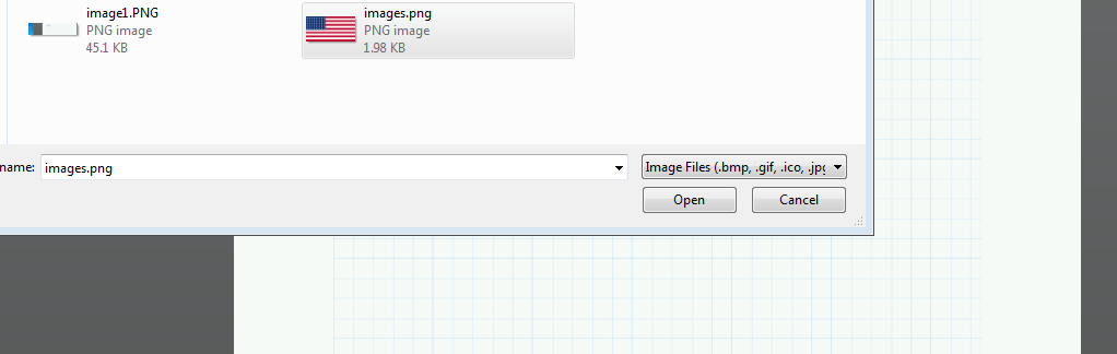

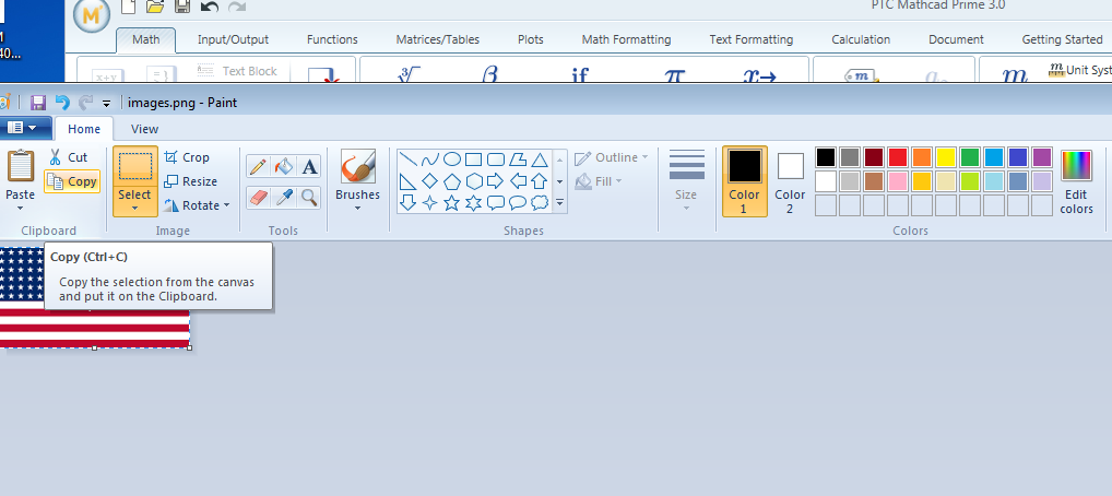

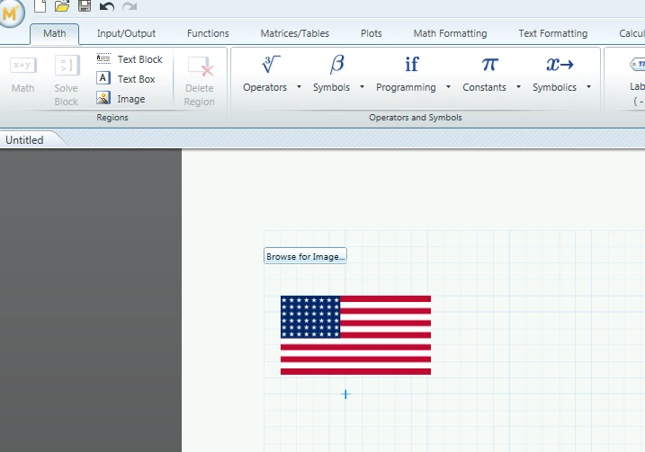

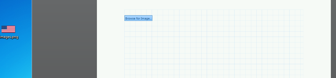

If I add a image block and try and browse to flag image it WILL NOT insert it.  If I open the flag in MS Paint and copy and paste it into MCP3 it will appear in MCP3 but I cannot save the file.  If I then remove the image from MCP3 and try and save it works.  This is happening on my desk computer and another computer in our lab.  I also have a free MCP2 at home and the same thing happens.

I did.  It turns out to be a FIPS security setting. My IT department had to take care of it.

I had the same issue (using PTC Mathcad Prime 3.1). This was such a deal breaker I almost gave up on trying to use Mathcad forever. Luckily, I found a workaround. Here's what worked for me:
1. Have a .jpg or .png file open. I recommend opening the file on Paint or similar software to allow you to easily scale the image (more below). Copy the image onto the clipboard by clicking on "Copy" or Ctl-c.
2. In Mathcad, click on the "Math" tab and then on "Text Box." This creates a text box on your work space.
3. While inside the text box, click on "Paste" or Ctl-v. This will paste the image! You can save the file without issue.
Note: It is likely that the image will have to be resized. Unfortunately, I was unable to resize it once it is pasted inside the text box. However, you can resize the image in the following two ways:
1. Resize image in the Paint program and paste it into the text box again until you are happy with the overall result.
2. You can paste image directly onto the Mathcad workspace, resize, then cut it (Ctl-x) and paste (Ctl-v) inside the textbox. DO NOT leave an image on the workspace, as it will create that saving error.
