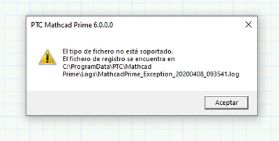

Cree un archivo creado en Mathcad Prime 6.0 y lo que estoy intentando abrir y aparece el siguiente error.
A continuación adjunto el archivo de registro que no se que hacer con el.
¿Cómo podría recuperar ese archivo dañado?
Gracias! Espero que me puedan ayudar.

This is likely a general error message indicating a corrupted or even invalid, incompatible or empty worksheet file <name>.mcdx cannot be opened.

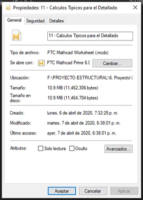

Can you confirm the file size that you are having issue with? Right click on the file > Select Properties and check the size of the file
If the file is less (in few KB's) in size it means the file does not consist of anything.

El archivo tiene un tamaño de 10.9 MB
Te adjunto el archivo para ver si me puedes ayudar a resolver.

I had a quick look at your file and unfortunately it seems that most of its contents are lost. Approximately the last 90% of the file consist of 0-Bytes only which means that there is no data to recover here.
The first megabyte (or less) is data, but its doubtful if any useful information could be extracted. PTC provides no means to repair defect file or at least give access to partially stored information.
Given the big file size my best guess is that to many / too large pictures bring the program down when it comes to saving the file.
I guess your only hope is a working backup so you don't have to start from scratch.
P.S.: All I could recover from you file were the two attached graphics, one of them only partial.
