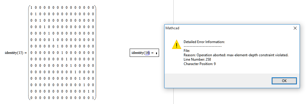

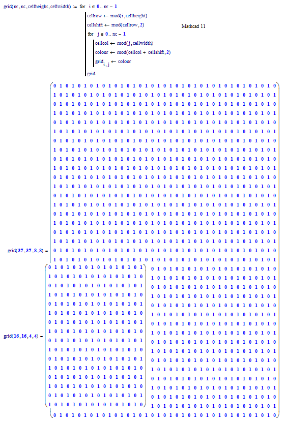

Stuart,
It's definitely a bug.
Here's Mathcad 11.2:
This is Mathcad 15-M030:
Both are run under Win7.

Stuart,

LucMeekes wrote:
Stuart,

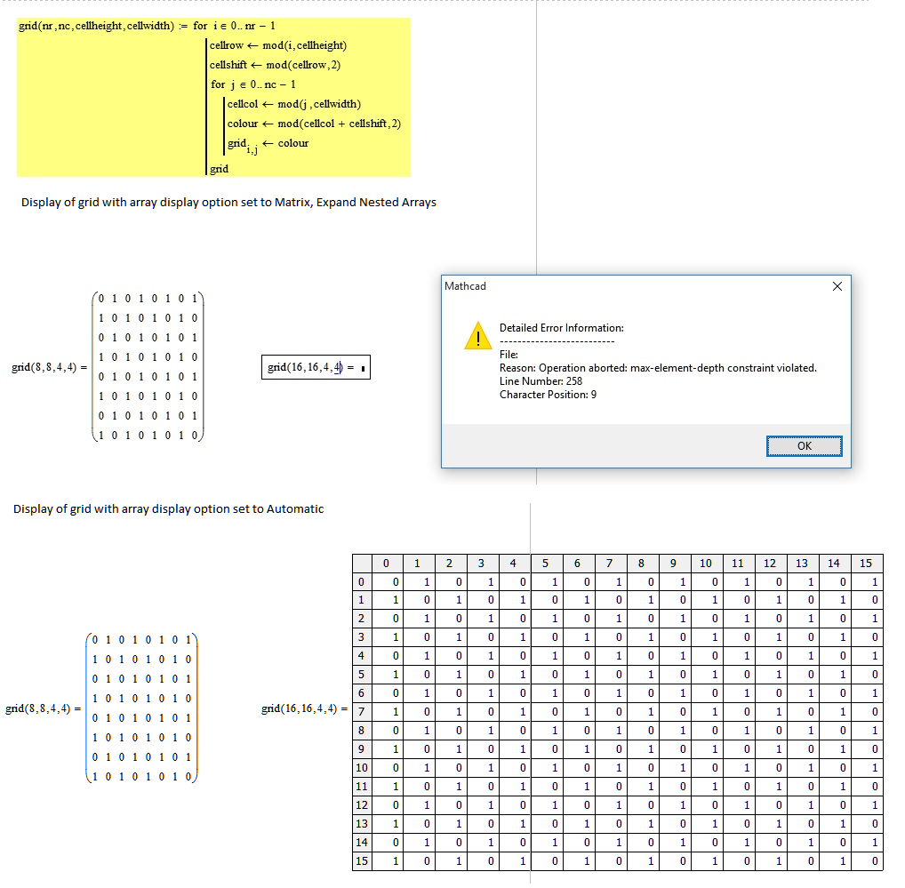

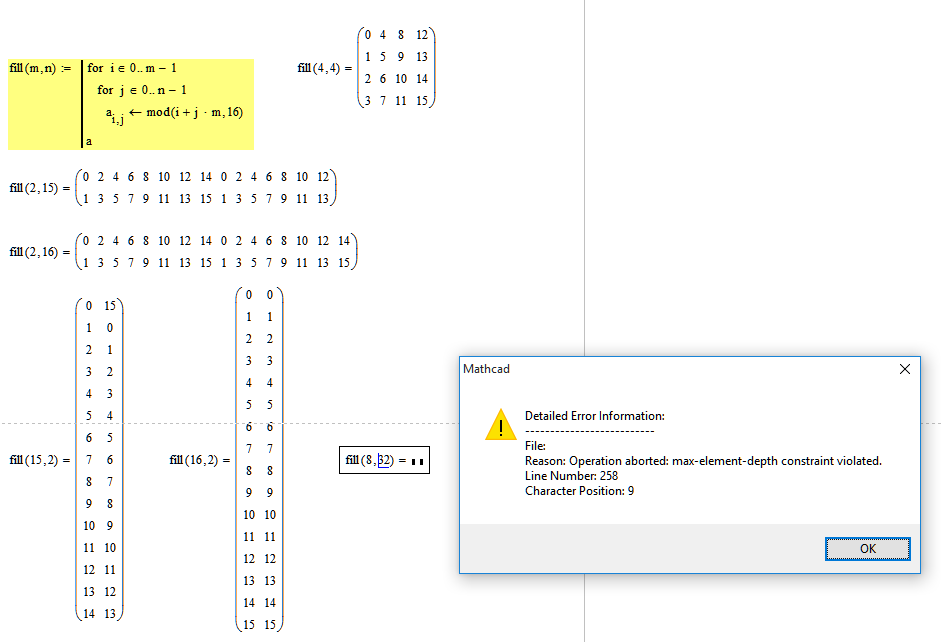

Thanks, Luc.  Coupled with Werner's input, it seems as if this is a new bug introduced in the 040 update.   It seems that the error occurs for 256 elements.
Maybe we can hope for Mathcad 050 before too long to fix it!
Stuart
Aug 26, 2015 6:28 PM UTC
Works OK in MC15 M030 Win XP

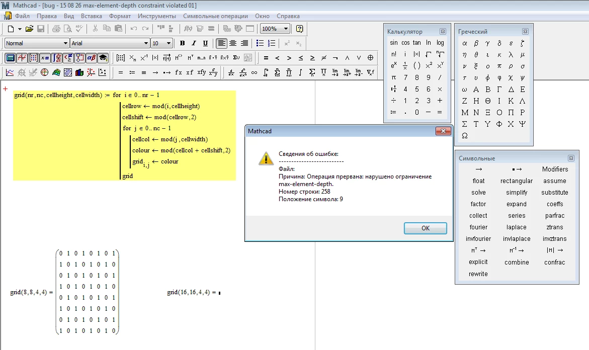

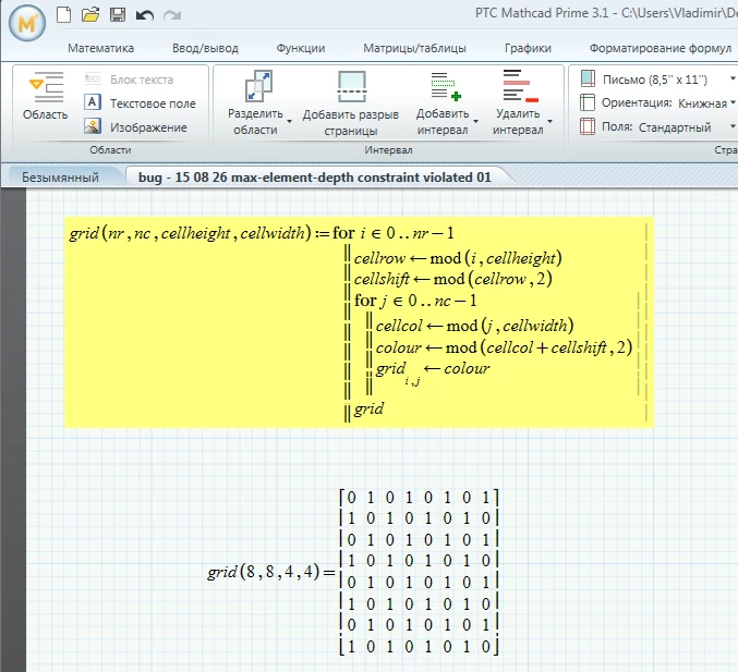

Hi Stuart,
I have reproduced this bug in Mathcad 15 M040 version:

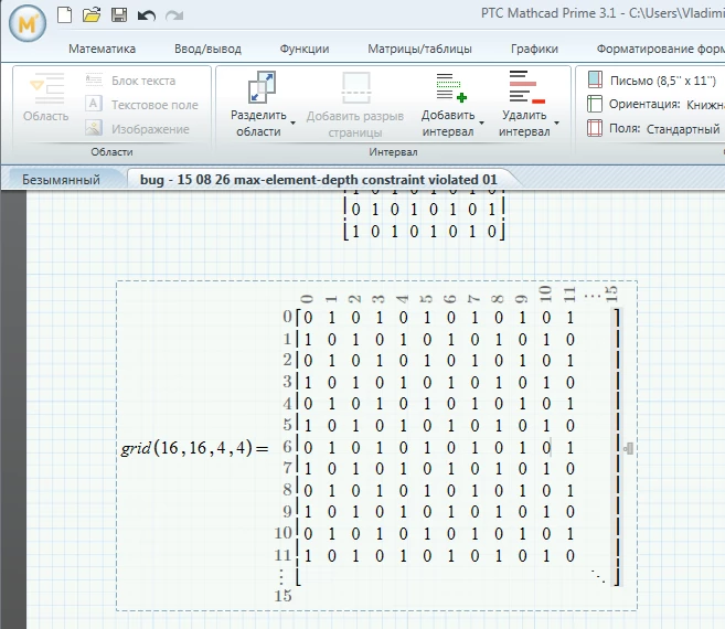

And here is a result in Mathcad Prime 3.1 version after converting the original worksheet:

VladimirN. wrote:
Hi Stuart,
Спасибо, Владимир.  So .. will there be a M15 M050 in the near future to fix this, and a Prime 3.2 to fix the lack of recursive local functions and The Image Problem? Pretty Please?
Stuart
