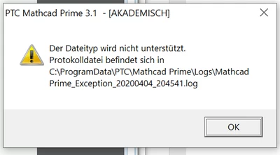

Every time i want so save my file this error message appears? Do you know how to fix it?

@Johnny0014
Does it happen with every file you try to save? Does it also happen if you open an already existing, saved file and you try to save it again?
Which file name do you try to save the file to? Did you try using a simple filename like "abc" (you should not need to type the extension *.mcdx).
Anyway, I have no idea what the reason what the reason for your problem may be, but I suggest that you contact PTC support.

@Johnny0014,
  • Rename the file MathcadPrime.exe.Config to old_MathcadPrime.exe.Config  in the location "C:\Program Data\PTC\Mathcad Prime"
  • Rename the folder PTC to old_PTC in the location " C:\Users\%username%\Appdata\Local"
  • Clear temporary files on machine
  • Try launching Mathcad using administration privileges.
  • If none of the above steps works you can try to uninstall and reinstall Mathcad Prime also, get in touch with PTC technical support for more assistance.
