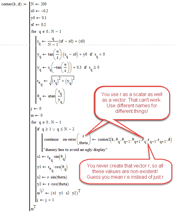

Could anybody help me with the error message in attached worksheet?
All the best
Payman
Werner_EAnswer
With r.e instead of r we get
Werner_E25-Diamond IAnswer
payman1-VisitorAuthor
Hello Werner,
I modified my worksheet but it is now taking too long to calculate. Can you take a look and see how I can save the calculation time,  please?
Should I post it as a new discussion?
Regards
Payman
At first sight I can't tell which routine is the most time consuming and how you could cope with that.
Opening a new question may attract more potential problem solvers than an already answered one.
