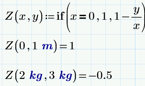

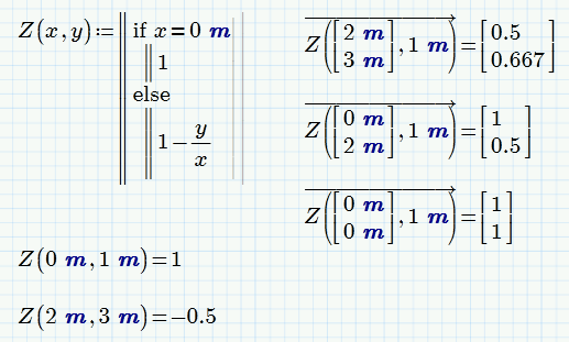

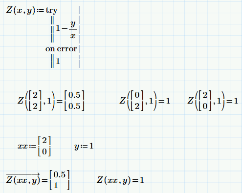

Here's one way to go.
Define a function to do the work and call it vectorized

X is NOT zero in either of the two cases. X is an array. Filled with 2 elements of 2 metres (first case) or 0 metres ( second case) .
0 is NOT EQUAL to any array.
Werner_E25-Diamond IAnswer

May 18, 2017 11:17 AM UTC
Well, this works, but there are interesting consequences:
