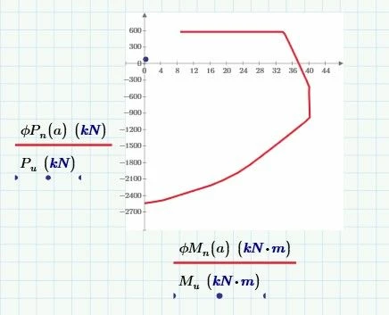

Dear Experts,
I would like to ask for some problems of my performing Mathcad Prime of creating Circle Column Under Combined Axial Load-(Pu,Mu). I can not plot the Interaction Moment diagram, I already tried to find the mistakes which could be made in the equation, but I still can not solve it by my own.
Since I am the beginner of using Mathcad Prime I really need help from all the professional users.
I would be really appreciated for your help.
PS: you can find the attached file below.
Thank you!

I can't open your worksheet with my older version of Prime.
But guessing from the screenshot I think that a should have some kind of unit, its not supposed to be dimensionless, right?
If thats the case, you must define a range "a" before you try to plot.
Keep in mind that to define a range with units, you must provide the first, the second and the last value.
For example, if a is supposed to be a length running from 3ft to 100 ft with a stepwidth of 4ft, you have to define

Problems stem back to this function earlier in the worksheet.
"a" is not present in the workings of the function?  Please check the function.
Here is the corrected equation
Change to range variable:
Plot with units in the unit placeholder:
Cheers
Terry

I can see the mistake!!!
Appreciated for your correction!
