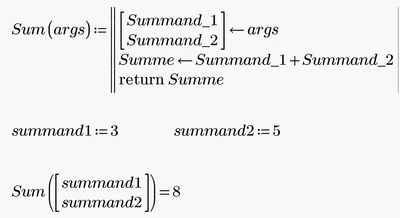

Use subscripted variables:

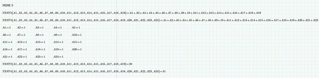

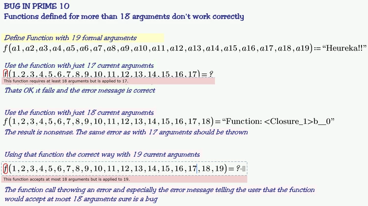

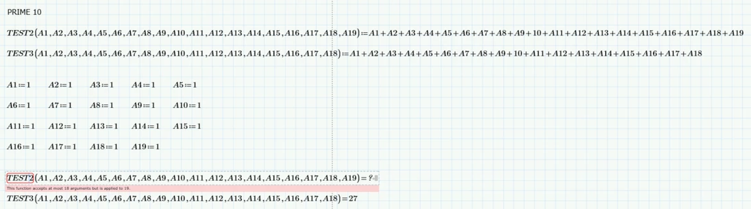

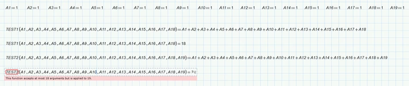

I can confirm that you found yet another a new bug in Prime 10.
Functions defined for more than 18 arguments don't work!
Feel free to go through the hassle and report it to PTC support.
The attached file is in Prime 9 version where the bug does not yet occur, so if you open the sheet in Prime 10, you have to recalculate the sheet to see the difference and the error occurring.
A workaround, as Alan already suggested, is to use a vector with all 19 or more arguments as the only function argument.  If you need more meaningful variable names in you calculations (you would have to use indexed vector name) you could do it (a bit awkward) as shown here:
Additional benefit of this approach is that neither the function definition nor the function call take up much horizontal space and don't spill over the right page margin 😉

I agree that it's weird, especially because I can replicate that Prime 9 accepts many more arguments than Prime 10 does, but I disagree that it's a bug, given that this is documented in Help:
https://support.ptc.com/help/mathcad/r10.0/en/index.html#page/PTC_Mathcad_Help/about_built-in_functions.html#
"All PTC Mathcad functions, built-in or user-defined, are limited to accepting a maximum of 16 arguments."
(I guess you could say Help is wrong in that it seems to be 18 arguments and not 16, but I won't press the issue.)

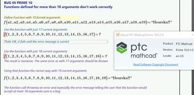

Oct 9, 2024 1:11 PM UTC
This has been fixed in Mathcad Prime 10.0.1.0.
This screenshot is of Werner's example with the function defined with 19 arguments. Note that in 10.0.0.0, using it with 17 arguments failed (as it should), the 18 arguments passed (as it shouldn't), and the 19 arguments failed (as it shouldn't).
In 10.0.1.0, 17 arguments fail, 18 arguments fail, and 19 arguments passed, which is expected behaviour.
(And if you give it 20 arguments it fails again, as it should.)
