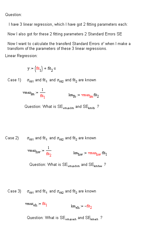

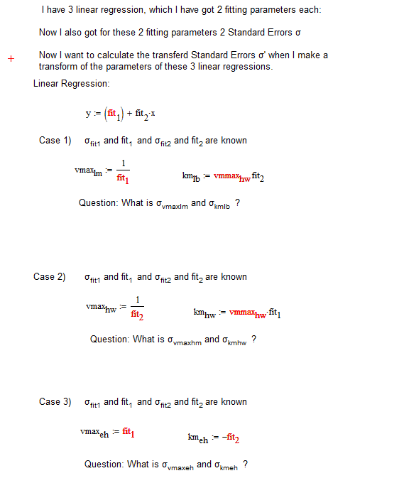

Richard, thanks. SOrry But I do not mean the Variance but the STANDARD ERROR SE, which is given and wanted.

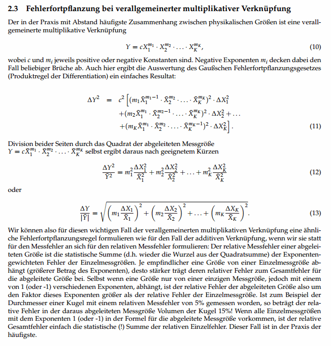

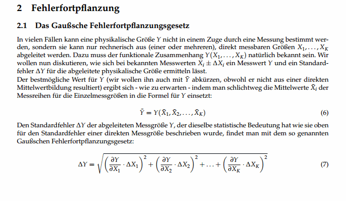

Moreover I have found this: Could this be also the right answer, I am little confused to compare these two.
