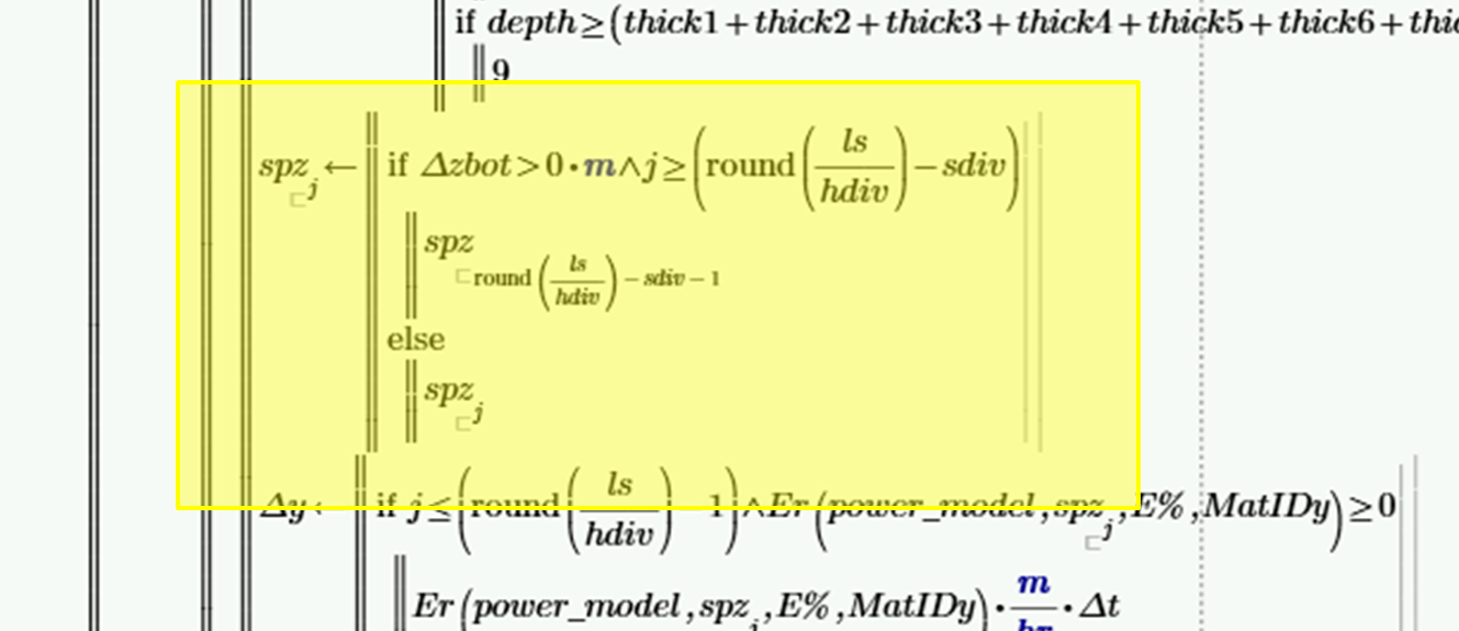

I have had to convert a MathCAD spreadsheet from one of the old formats to Prime 2.0 and I am having trouble with program functionality. The spreadsheet is essentially a group of sub-programs or routines that are called on in a larger program further down in the sheet (pg. 37). At this point the program will not run due to a "These values cannot be compared" error. I have converted similar worksheets with essentially the same sub-programs and sub routines and not had this problem. The error appears to be the Evolve sub-program (Pg. 33) but it does not provide the source ofthe error.
Any explanation as to what is wrong and how to fix it would be appreciated.

It seems to be pointing me to this portion of the Evolve subroutine. It looks exactly the same as a spreadsheet that I converted previously (that functioned normally). I'm still not sure what exactly is wrong with this or how this is causing the error.

Sorry - the function round has 2 arguments.
August 23, 2013
You MAY use 2 arguments with round(), but you mustn't - the second argument defaults to zero. So the syntax in the shown code snippet is OK!
Valery, maybe you confused it with Round() (note the capital R) - here you need two arguments.
