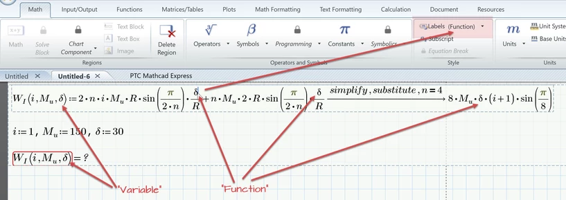

Error: This value must be a scalar or a matrix

The question was also answered here
You have to manually label the two deltas as "Variable" or "-" = "Automatic"

would you happen to know why only delta was defined as 'function'? but not the other ones (i and Mu)?
I am wondering if I copied and pasted it from somewhere else or if it's because it is a Greek letter
23-Emerald V
Jun 9, 2025 8:10 PM UTC
It is due to the intricacies of the enigmatic 'autolabelling' feature of Prime.
It's a nice feature, and often it helps. Too often it strikes wrong.
What helps is if you make all label types look differently, e.g.:
LucMeekes_0-1749499654960.pngLucMeekes_1-1749499666294.pngLucMeekes_3-1749499696785.pngLucMeekes_2-1749499688206.pngLucMeekes_4-1749499715551.pngLucMeekes_5-1749499724104.pngLucMeekes_6-1749499731834.png
Then you immeditely see.
