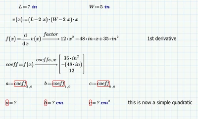

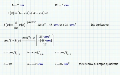

Error when changing from cm to inches
My calculations fall over when I change to inches. Prime 8 Used.
Then won't work when I chage back to cm

Add this to eliminate errors after W:=5 in.

Seems to be a new bug introduced in P7 or P8.
I don't experience this erroneous behaviour in P6.
Maybe it helps if you activate "Units/Constants in Symbolics" in the Calculation Options.
