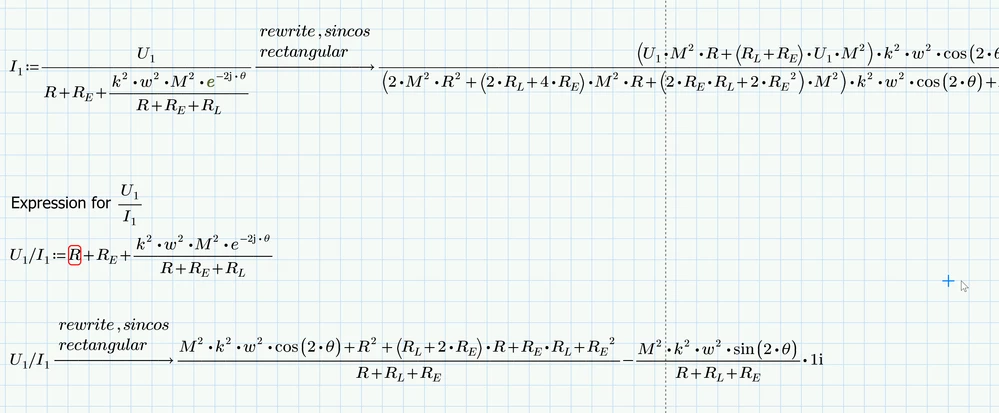

MW_10727886_0-1690342850423.pngHello, I am solving a circuit equation in Mathcad 9.0. I want to express the above equation as cos and sin identities (Basically expanding Euler) .I want the equation to look like U/I form .

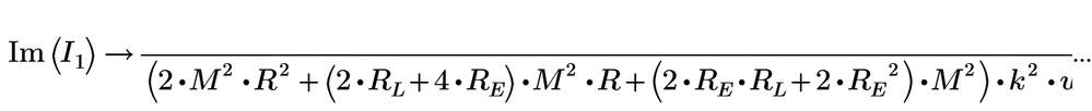

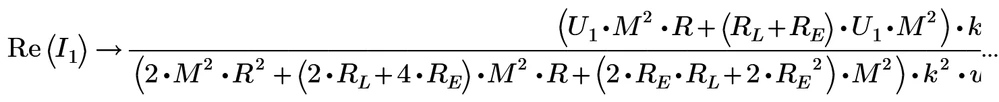

The imaginary part is zero because Prime assumes all unknowns to be real and you did not provide any non-real quantity.
Guess you should have written
or
instead of
Using the modifier "rectangular" may also be helpful
BTW, "rewrite, sincos" isn't necessary anymore if you use "rectangular" or Re(...) and (Im(...)

Anyway, with the proper substitutions your expression is:
Symbolically you can do:
One step further gives you:

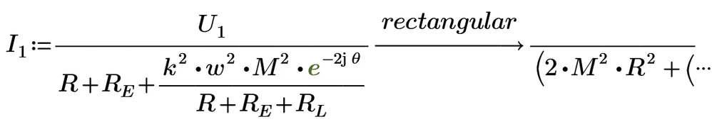

image.pngimage.pngimage.pngimage.pngYou must write like this.
