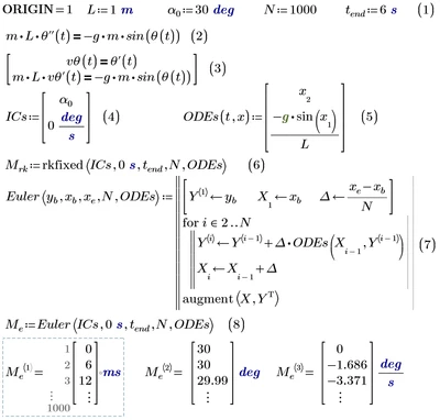

But I did not find there the name of the greatest mathematician - Euler. We need to fix this and make the Euler function built-in Mathcad for the simplest numerical solution of the ODE.
Especially now, due to the high calculation speed, there is a return to simple algorithms - KISS!

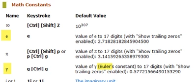

According to Wikipedia, Euler has a number, a constant and a characteristic named after him:
Euler's number is: e=2.718...
Euler's constant is: gamma=0.5772
Euler's characteristic is: 2, the sum of the numbers of vertices and faces minus edges of a polyhedron.
November 23, 2022
In Wikipedia but not in Mathcad 😪
It will be good to have Euler built-in function for ODE solution in Mathcad.
Are you sure? 😉
