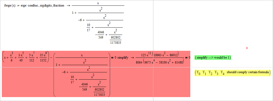

Euler's Continued Fraction Formula Problem.
Hello, Everyone.
Please help me solve the problem.
Thank you in advance.
Regards.

Try using the confrac symbolic keyword.

I'm not familiar with continued fractions (that is, I've forgotten everything I ever knew about them), however, are you guaranteed to have an exact solution for any given number of 'continuations'?

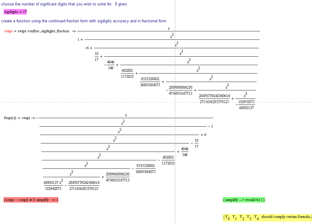

If you change sigdigits to 17, then you get an equality.
