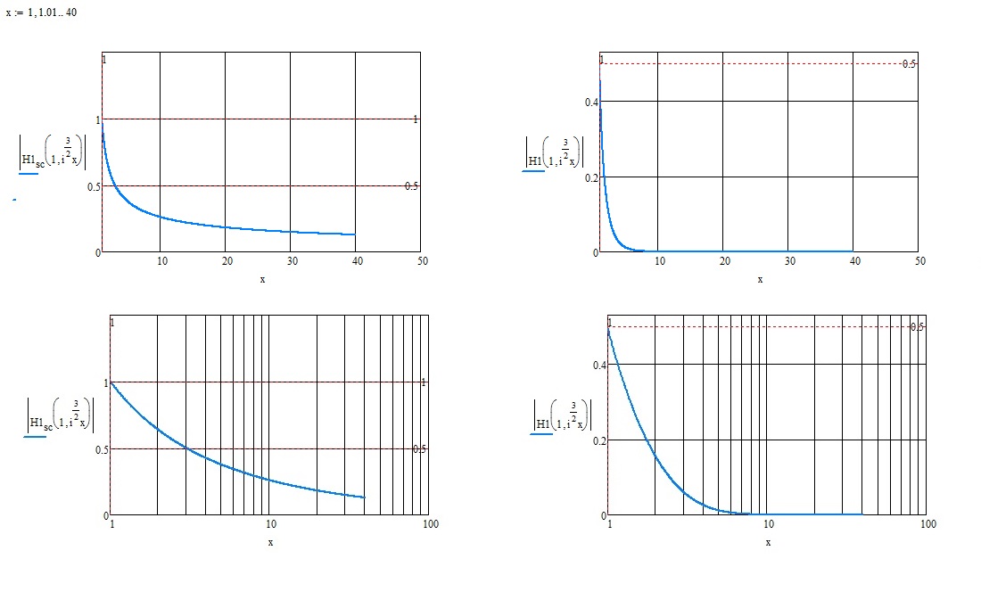

I have plotted the module of Hankel functions of complex arguments and I found an oscillating behaviour. What is the reason of this behaviour? how could be overcome?

How effectively use the scaled functions in order to evaluate an hankel function? The scaled Hankel function must be re-converted to Hankel  functions by using the appropriate scale?
May 26, 2016
My previous answer was a bit rushed having found  a solution to the problem. But I see that even without scaling the graph does not present oscillations.Hankel.jpg
