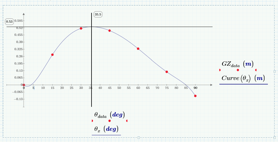

I am looking at a problem whereby I have a series of coordinates which I have used to plot a graph.
I now need to evaluate the graph in two ways. One I need to find what the largest value on the y value is and then the point at which the curve crosses the x axis (for the second time).
I can do this by eye and say that y is larges at ~0.52 and the curve crosses the x axis at ~84 degrees.
Is there a way to evaluate this mathematically to get a more accurate approximation?
Also can anyone tell me how I can increase the accuracy of the scales i.e. the points on the x axis of interest are currently 81 then 90. How can I show more points i.e. increments of 1 degree on the x axis?
Andy.

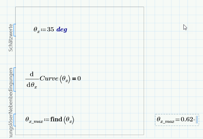

change the unit from Thetaxmax to °:
12 replies
Apr 20, 2017 8:23 AM UTC
Hi Andy,
Answers see attachement.
Hope it will be helpful.
Best regards, Volker

Ah! I'm working in MCP4. So lets communicate via PDF-File.

Klick the second number on the x-Achse and change it to e.g 5.
Mathcad takes the steps in5 steps up to 90.
see this:

I've looked through the PDF as I cant open the Mathcad file. I am clearly not doing something correctly as I get a different value to you?
