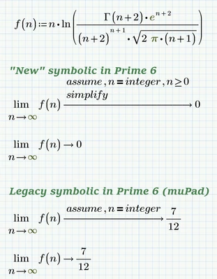

ADDENDUM

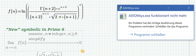

By replacing the factorials by the gamma function I get the very same WRONG result in Prime 6, too!
Here is another "nice" experience I had while playing around (still in P6) - its reproducable

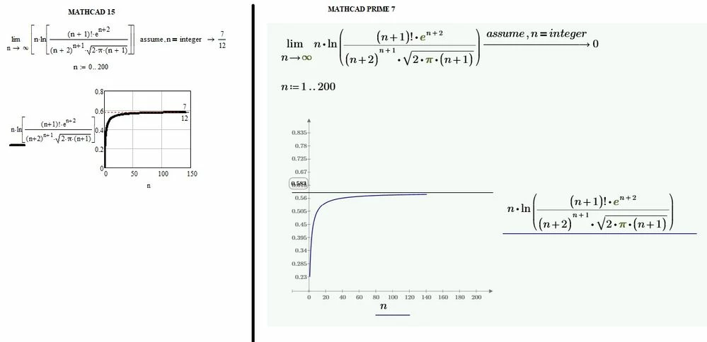

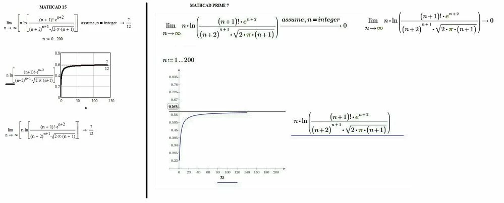

March 19, 2021
Mathcad 11/Maple:
can do without an assumption.
How does Prime7 fare without the 'assume n=integer' ?
-MFra-21-Topaz IIAuthor
March 19, 2021
March 19, 2021
I'd say, report this crime.

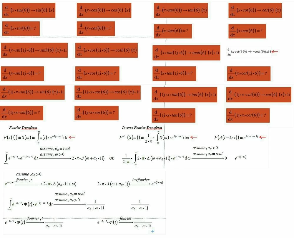

Similar complaints have been posted in the community for years. It seems to me that Werner and others, from time to time, report it to PTC but without getting anything although, if you check, some old errors (see photo) have been corrected, but not all.
There is a more complete list.
((Note that all other software suffer from similar errors but not the same)...)

March 19, 2021
MP5 works.  So I guess the new symbolic solver isn't actually a solver, symbolic or otherwise. ☹️
