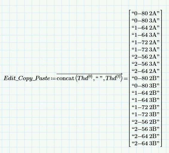

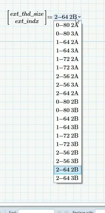

Hi
Have created one matrix with the data
Created a column vector called Edit_Copy_Paste that concatenates two columns.
Used Copy and paste to get this column into the editbox in one copy and paste operation that includes full column.
Cheers
Terry

Found the example I was looking for from past posts.
Enclosed is an Excel file with actual data 2091 rows by 166 columns.
Prime sheet has two combo boxes one to select an individual row with 2091 entries and one to select a column with 166 entries and it outputs the data in the relevant data cell as an example.
For the Prime read excel data statement the path will need to be adjusted for your system.
Statements to create the combo boxes within Prime are located on the Rows and Columns worksheets.  I did not type the 3000 odd entries in the Prime combo boxes but let Excel create them.  It is just copy and paste to get them into Prime.
Is this the sort of thing you are after?  I can explain in detail if it is.
