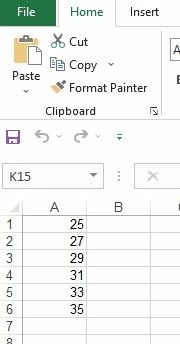

Is it possible to keep on adding output of excel files with change in output to one single output file?
For e.g. there is a input file which provides the data and evaluating the worksheet will give excel output. What I want to have is when the input is changes it overwrites the excel output but i ant to have the calculation written in next row of excel document like it used to do in Mathcad 15. I tried but could not achieve it. Can someone please share the sample worksheet with this behavior?

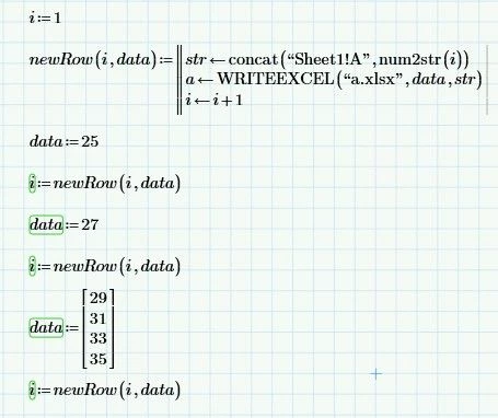

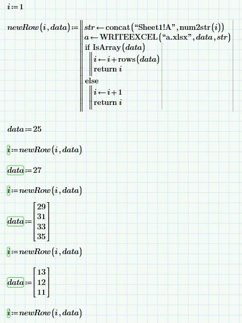

This keeps track of the next row in Excel for writing new data:

Needs an update:
8-Gravel
October 28, 2022
Thank you for the sample example it really helps a lot
