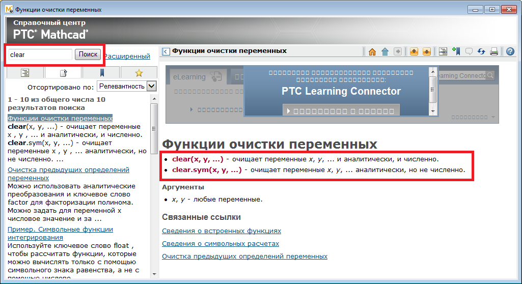

In Mathcad Prime there are built-in functions for cleaning the set of variables. Functions of cleaning of variables: "clear(x, y, ...)" and "clear.sym(x, y, ...)".

I am using Mathcad 15 and dont see the function
August 31, 2015
This is a new function for Mathcad and is only available in Mathcad Prime.
August 31, 2015
But I guess it would not help to automatically update Excel components either (if that was the question - not sure).
