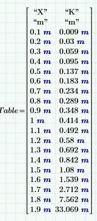

If you (in the EXCEL file) select and copy only the numbers, then paste them into Mathcad, Prime will create a table with the numbers but with un-declared variable names and units.  You can then fill in the names and unit values and the table columns will work like vectors in Mathcad.  An example is attached (Prime 8).  Your example (with multiple columns with the same names would be challenging, and using the same calculations with a different set of data would be an issue.

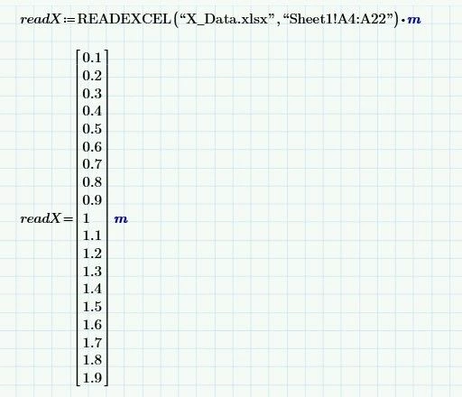

Jan 11, 2023 3:39 AM UTC
It is easy to multiply the excelread statement by the expected unit.
When augmenting and stacking matrices the rows of each augment and columns of each stack should match
This gets the required matrix.  It is not an input table.
Cheers
Terry
Jan 11, 2023 4:01 AM UTC
Yes, but is looks like the desired unit is mm, not m.
And as can be seen in the sheet I posted above, you have to make a compromise - either a text header or the preferred unit showing or a table without units at all 😞
