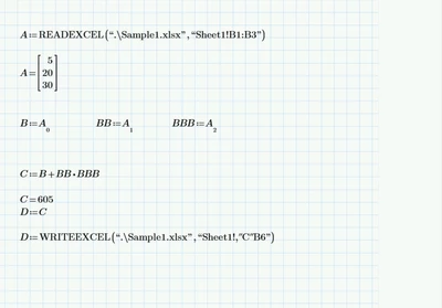

I want to get the input from excel do the calculation in Mathcad prime and return the output to same excel sheet is it possible.

You may use the READEXCEL() and WRITEEXCEL() functions. Look them up in the help.

I tried to look into Helpcenter but not getting the expected results maybe I am doing something wrong
I want to write result D in specific cell of excel that I am unable to do

Read the help info on WRITEEXCEL again to see what you should do to write data.
