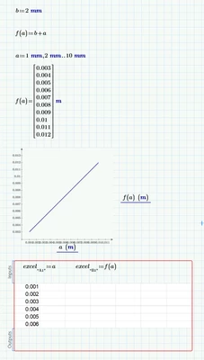

Hi All,
why mathcad prime dont allow to input the results of a fuction with a range of input into the excel component. What is the way to go around this?

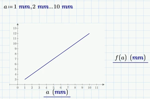

Its fine and OK to use your range "a" for plotting

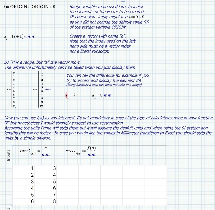

For other things you rather should create and work with true vectors as shown and explained below:
Prime 10 sheet attached

1. The output to Excel accepts only arrays, yours is a range.
2. The output to Excel accepts only unit less data, yours has a length dimension.
Jul 13, 2024 10:14 PM UTC
Actually "a" IS a range and "a" is NOT unit less, but still "a" IS accepted by the Excel component as input! 🙂
The problem is f(a), which neither is a range nor an array/vector.
