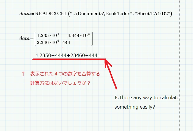

I want to put out a total of excel's table by Mathcad.
I could inport excel's table.
I can't calculate.
Is there any way to calculate something easily?
Please find example in attachment.

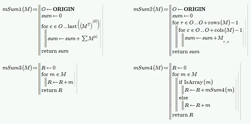

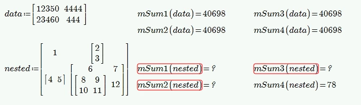

I guess this thread could (and should) already be marked as "answered", but, for whatever its worth, here are a few more approaches:
