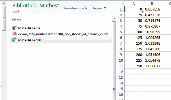

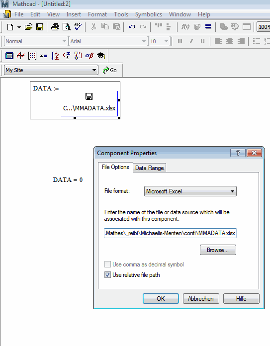

I tried to import an XLS Sheet, which was generated by MMA (with 30 digits after the comma) but get problems. The DATA is always 0.
Can anyone here confirm this with MC 15 M045?

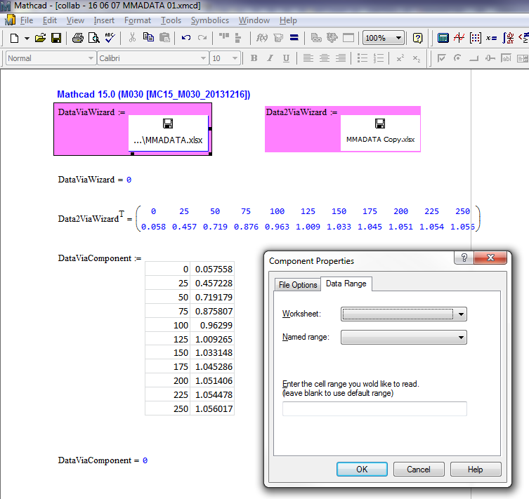

I get the same thing, Walter, in a slightly earlier version of Mathcad.   However, when I made a copy of your file (using Save As), then the Excel Wizard/Component worked (see Data2ViaWizard).
What's amusing is that the Component shows the values in the table, but still returns 0.

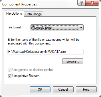

I can't change the decimal symbol, though ...

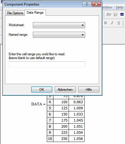

Did you check the settings on tab "Data Range"?

Werner, yes if I do know,
But I can not select teh DataRAnge, and I want to use default as mentioned in the line.
