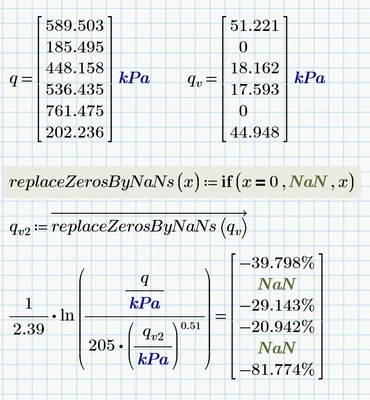

Werner_EAnswer

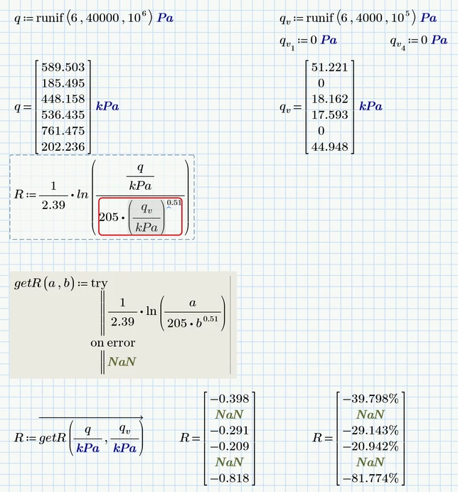

If you really prefer to rather modify the vector, replacing zeros by NaNs, you may do it like this:

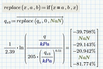

Personally I would prefer using a more generic, versatile utility function

Why don't you just use "try... on error...." in the calculation of R ?
BTW, writing 100% has no effect, its just a multiplication by the number 1.
If you wan the result to be displayed as % value, you have to format the result accordingly.

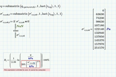

The gef Excel workbook cleared up the initial errors..  There are quite a few further down the Mathcad worksheet, though.  More importantly, there are only 26 pages, so page 28 has gone walkabout.  I couldn't find an area in the Mathcad worksheet that looked like the above, either - although I might have missed it.   Can you check please check that the Mathcad worksheet you posted is the same one that has the problem? (I've sometimes been guilty of not saving a worksheet before posting it, so these things can happen)

No need for a 28 page worksheet which takes long to load, takes long to finish calculating and does not contain the problematic region at all!
Better for future questions: Create a small(!!!) worksheet with dummy data which shows the very same error!
Werner_E25-Diamond IAnswer
