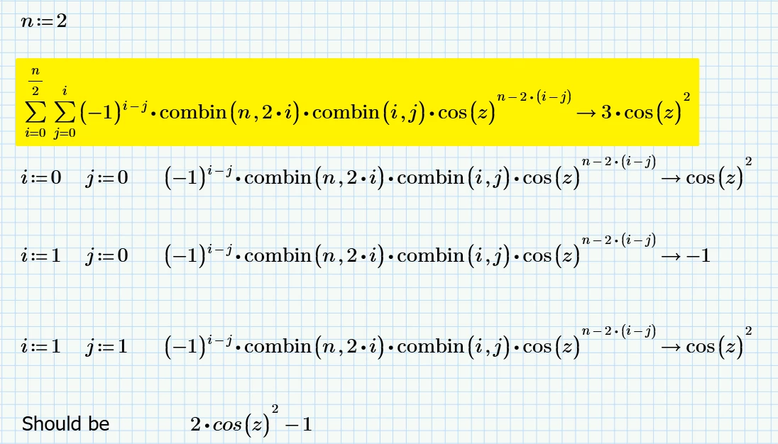

The following Mathcad code attempts to use a formula from Wikipedia to expand cos(n*z), but appears to get the wrong result. Comments?
Mathcad code implementing expansion formula

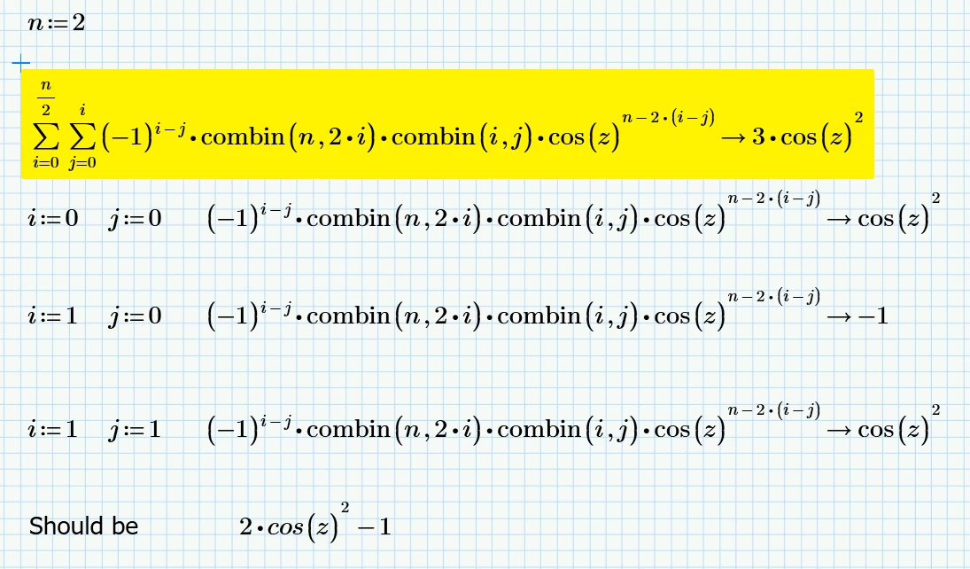

Aug 7, 2026 4:37 PM UTC
Image file of embedded picture in the original post

I can’t test it in Prime as I have no access to a full version of Prime, but I agree that Prime’s result of the symbolic evaluation which you highlighted in yellow is wrong. It should be cos(2z), equivalent to 2 cos²(z)-1 as you wrote.
You may consider contacting official PTC support and report this bug in the symbolic engine.

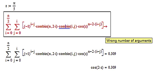

The error messages displayed are confusing and I can't make sense of them.
My first guess was that it may have to do with a faulty implementation of the ‘combin’ function, but this seems not to be the case:
Nonetheless MC15’s symbolics returns wrong results. Calculation of the following two expressions should be the same as “i” only has the value 0. Nonetheless only hard coding the zero as limit of the second sum gives the correct result.

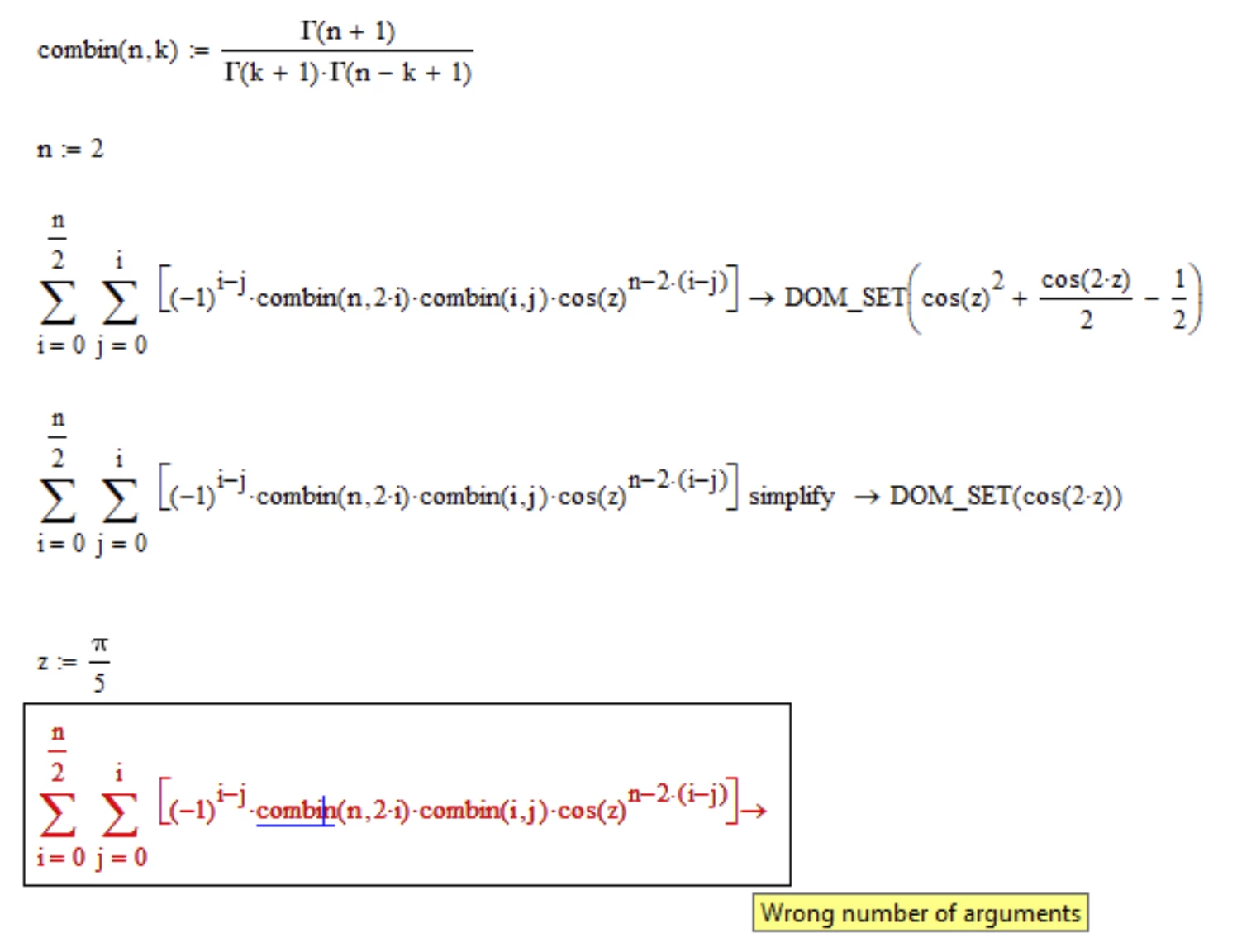

No big surprise that Maple in MC11 performs way better than later versions.
Here is the MC15 result when redefining the ‘combin’ function - the results are OK, the usage of DOM_SET a bit strange
​@AD_2895922
Which result do you get in Prime when you redefine the “combin” function (either using factorials or the Gamma function)?

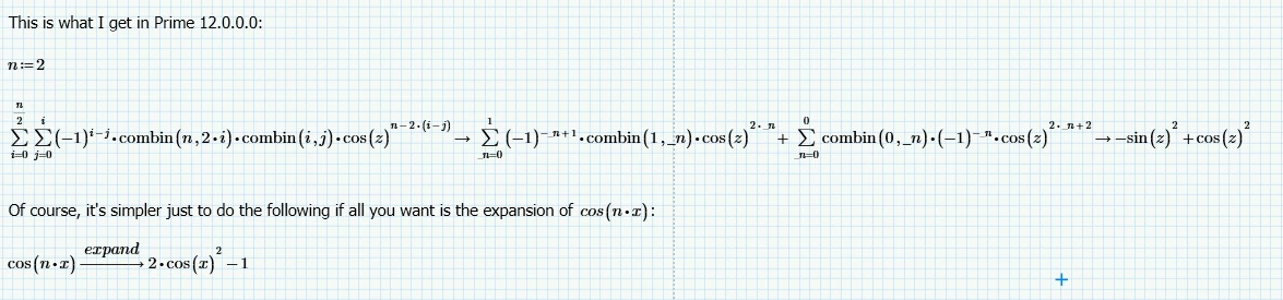

Here’s what I get in Prime 12:
Aug 9, 2026 9:18 AM UTC
So the bug is already fixed in Prime 12.
