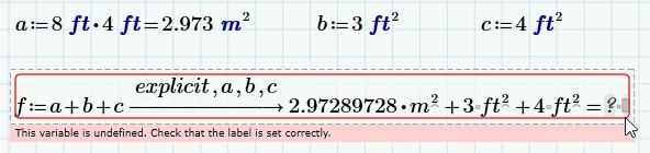

Maybe I'm doing something wrong, but I can't seem to figure it out. There are several posts that show examples of explicit working quite well, but for some reason I can't get it to work.
Here is what I'm trying to replicate:
And this is what I get:
Also, is there any way to hide the whole "explicit,a,b,c" part?
Thanks in advance.

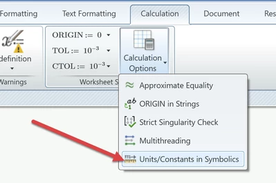

You should turn ON units... in symbolics via the calculation options
and then recalculate the worksheet (press F9 or F5).

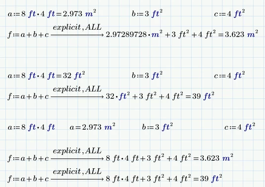

You may also use "explicit, ALL" and of course you always can manually change the unit meter to feet in numerical results:

Can't replicate your problem:
You can hide the area but looks like not so explicit any more.
DJNewman
May 20, 2024 9:20 PM UTC
What if you did something like...
Also, hiding the keywords in a symbolic expression is a common feature request but as of Mathcad Prime 10, not currently implemented in Mathcad Prime.
