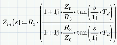

Say I have an expression:
Z(s):= c(s)[a(s)+b(s)]; where s is a variable
When I evaluated them, they are not the same.
Z(s)=
The results is not the same as:
c(s)[a(s)+b(s)]=
Please see attached for a better explanation. The bottom right row result is not the same as the bottom left result. Bottom right row is correct

Your function Z(s) is NOT dependent on "s" but on "freq". If you want it to be dependent on "s" you would have to write
EDIT: The pic showed the wrong expression - replaced it for the correct one.
rdliquid1-VisitorAuthor
Hi Werner_E,
Thanks that's it and it makes sense to me now. Still trying to get comfortable with Mathcad 6
Thanks a lot!
