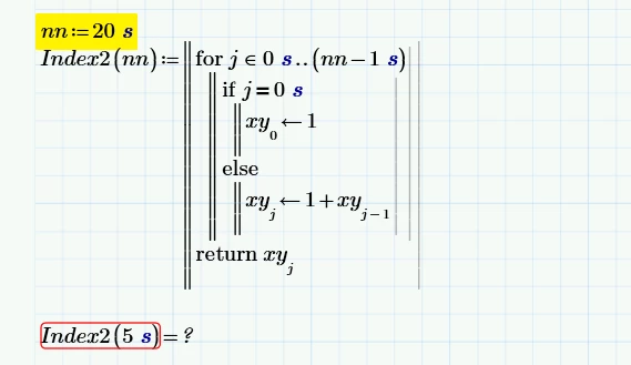

I need to get around the part of following programming where I need the variable to assign units (seconds in this example). It is not going through.
I request someone help me:  Thanks a lot

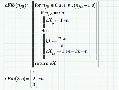

You may consider using this to create your array:
Result:

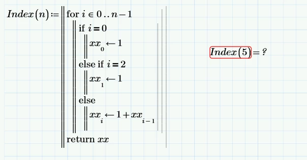

The element of xx with index 2 never gets a value, so when i=3, an error occurs when trying to access that element.

You cannot attach units to a variable that you use to index (point at) elements of an array.
If you want the array elements to have units, attach the unit to the elements, or attach the unit to the array at once in the return statement.
Result:

Thanks. It is a help to improve my skills. I also got round s follows.
