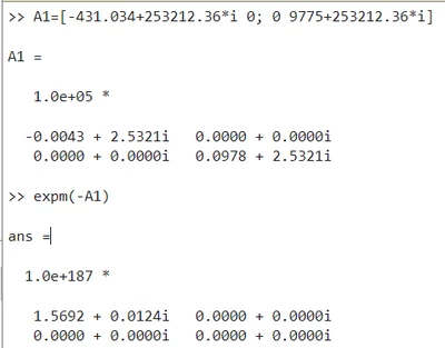

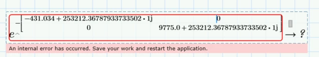

Exponential with matrix as exponent calculation error: Save your work and restart the application
Matlab result:

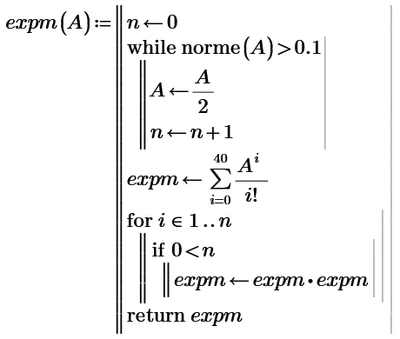

Hm,, I think I found a way:
By using this
But others opinions are welcome

What I also see is this:
But of course, the j must be there
By using this

Apr 1, 2024 4:56 PM UTC
But anyway, can someone spot why is not possible to run with j:
While without j is possible:
