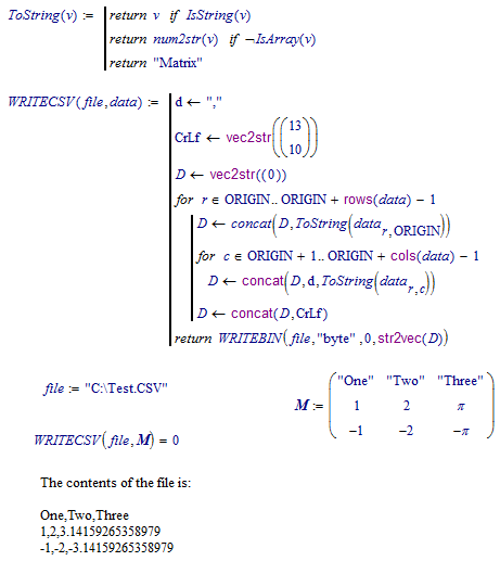

I don't have Prime 3 (but Express Prime 3.1 and 4). But I do have Mathcad 11.
You should be able to write a program like this in Prime 3 to produce a .CSV formatted file from a matrix:
