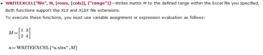

I was trying to export the data from Mathcad to an already made excel file but it is not letting me to. It lets me to a new file but not an existing one

Your command:
From Help:
Your arguments are in the wrong order. I would leave out the row and column values and the !B5  and see whar happens
