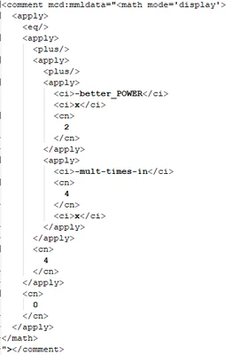

-> Mathcad 2001, 2001i and 11 have an option to 'Save as' a "HTML/MathML File (*.htm)" .
The expression:
creates this MathML:
Did they drop that 'Save as' modality in Mathcad 13, 14 or 15?

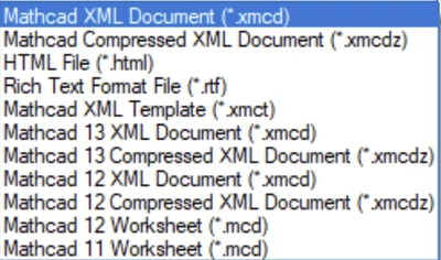

Yeah! Here is what MC15 offers with "Save as":

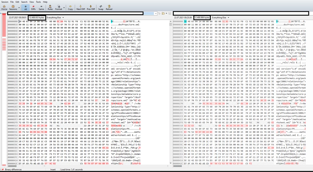

July 21, 2021
Hello
as requested the comparision of two conversions:MC15 in Prime 7 Converter - Comparision of several conversions.png
cite: You'll have to write your own converter, examining the XML of the Mathcad file.
TBH: If it would be so easy as you said then the competitors would generate a input interface. But they don't do it. Second: I am a HW engineer and I do not write a script to parse XML. This is not my job. My employer pays much money to get a maintenance and I receive a converter which works sometimes sometimes not. I want to trust the converted scripts. And I don't want to check each formula if there is an error or not. If I would print the WCA on a paper I would waste 200 pages of paper.
