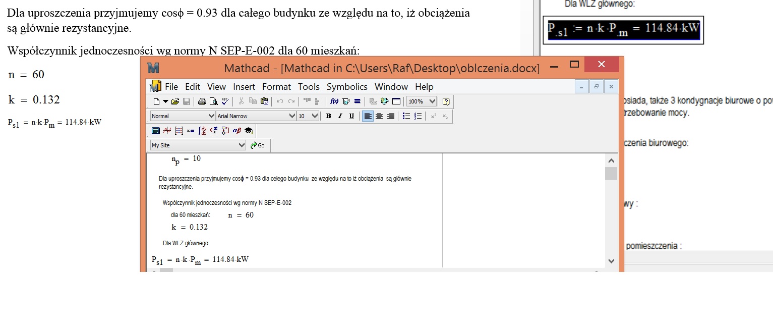

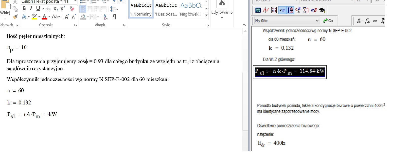

Recently I finished my project in mathcad 15 but for the perpuse  of print editing, I need to copy text and equations to word. I dont have any problem with text but when i copy equation the result of equation is gone:
If I double click on the equation in word the extra mathcad window will open. Thanks to that I will get the result of equation but  font will be changed permanently:

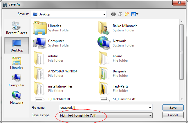

it is better to use the "save as..." feature in the file menu. There you can choose to save the mathcad document in rich-test-format. This can easily be imported in MS word.
Raiko

Instead of highlighting the equation and copying, try selecting the equation using the mouse and then pasting into Word. The equation and result will be inserted into word as an image.
Mike
