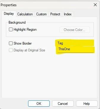

Every region in the worksheet has a property called "Tag".  You can set this for individual regions to the same value.
It is possible in vbscript to read the Tag property to see  which ones are tagged and respond accordingly.
Right click  on a region in Mathcad 15 and select Properties.
You get this dialog box to set the Tag.
' MathcadExtractText.vbs
Set Mathcad = CreateObject("Mathcad.Application")
Set Worksheet = Mathcad.Worksheets.Open("F:\Prime\VB\worksheet.xmcd")
Set TextFile = CreateObject("Scripting.FileSystemObject").CreateTextFile("F:\Prime\VB\output.txt", True)
For Each Region In Worksheet.Regions
 If Region.Type = 1 Then ' denotes an expression region in Mathcad
 bstr = Region.Tag' Region.XML does not work either.
 tokens = Split(bstr, vbCrLf)
 For i = 0 To UBound(tokens)
 		 TextFile.WriteLine(tokens(i))
		Next
 End If
Next
TextFile.Close
Worksheet.Close
Mathcad.Quit
ThisOne
ThisOne
