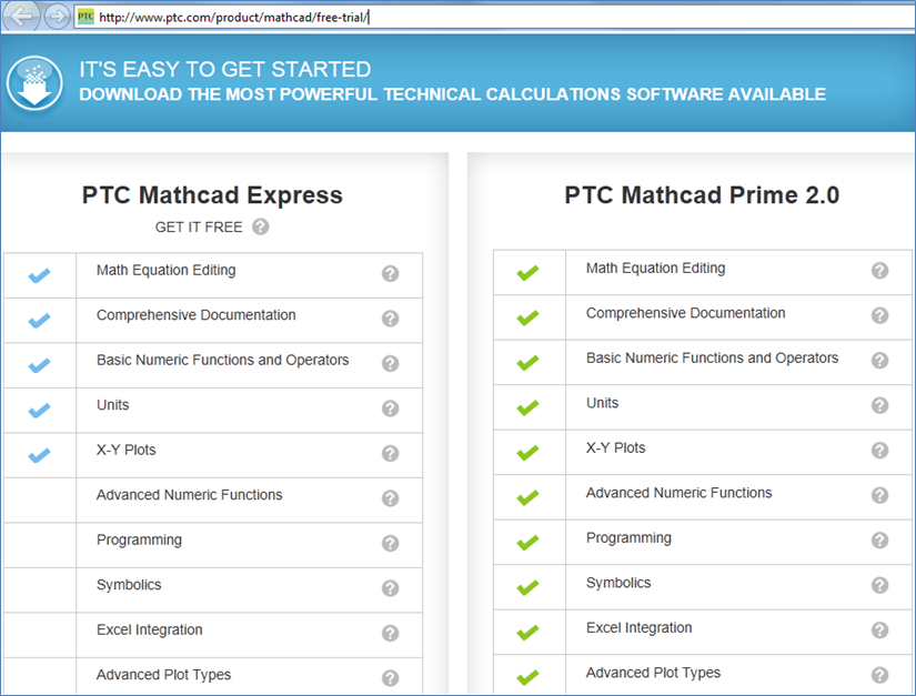

express and prime comparation
could you tell me mathcad prime and express comparation?
6 replies
Does IF statements count as programming?  or does it mean pure C++ or VB codes?
23-Emerald I
There is an "if" in the programming menu that almost certainly won't  work in express.
There is also an If function, very similar to the one in EXCEL:   if(test, return if true, return if false)
That one might squeak past.
